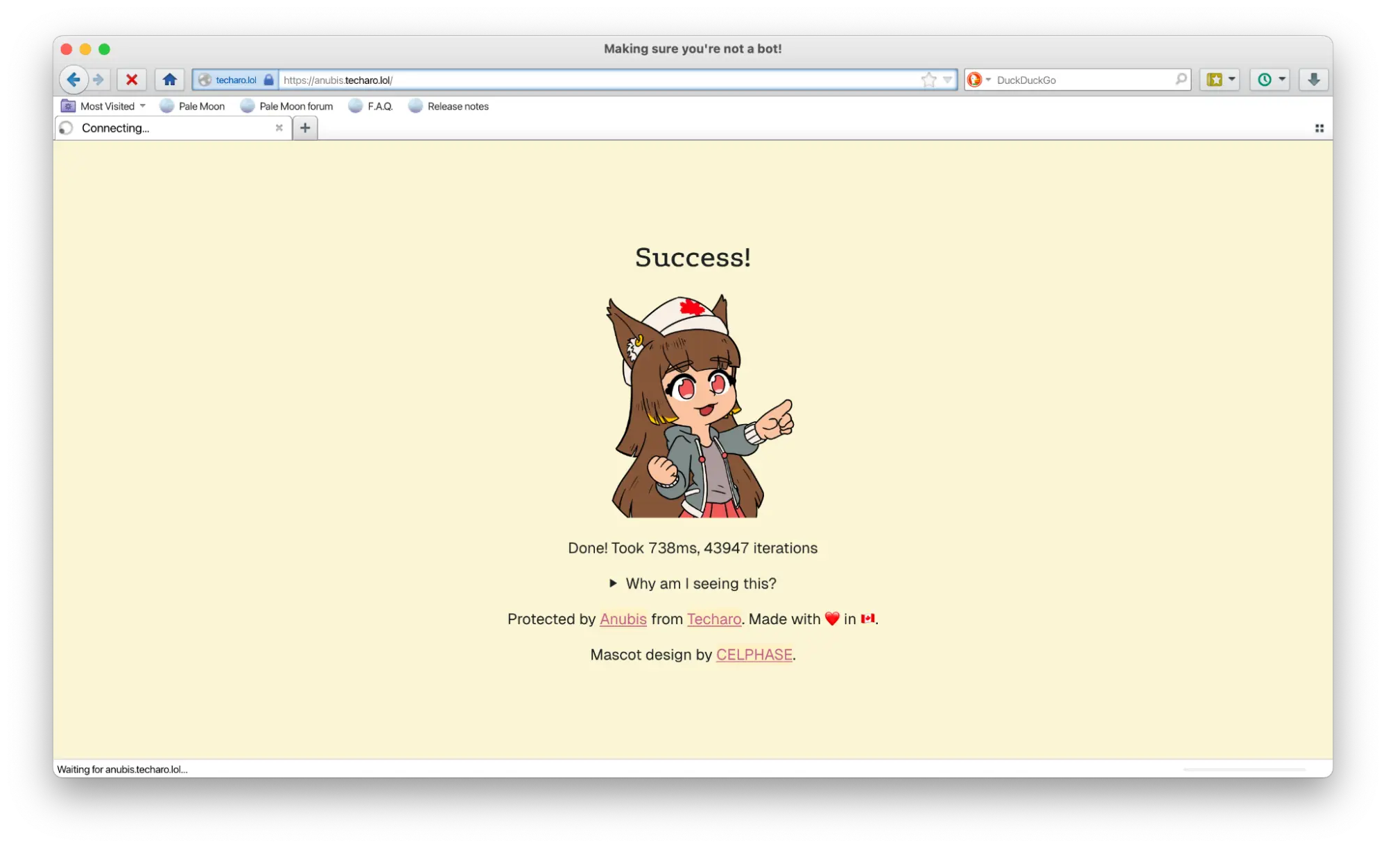

Anubis running on the browser Pale Moon, which has been infamous for Cloudflare deciding it doesn't meet security muster
I'd like to have Anubis throw challenges less often than it does right now, but there are a few key problems that interfere with this:
