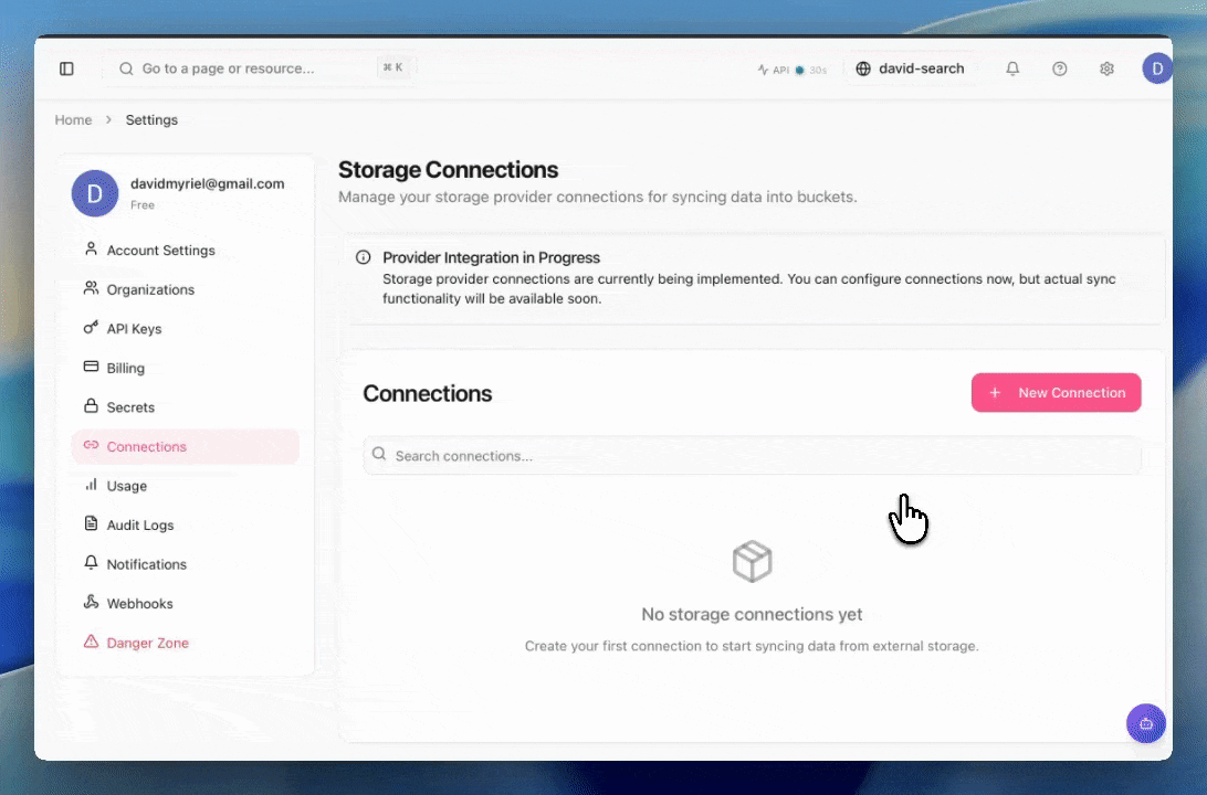

## How Mixpeek connects to your Tigris bucket[​](#how-mixpeek-connects-to-your-tigris-bucket "Direct link to How Mixpeek connects to your Tigris bucket")
Connecting Mixpeek to Tigris follows the same S3-compatible authentication pattern. You grant Mixpeek read access to your bucket using standard IAM-style credentials, and Mixpeek uses those to discover and retrieve objects for processing.
The GIF below shows the end-to-end flow in the Mixpeek dashboard:
![Creating a Tigris bucket and connecting Mixpeek](/blog/assets/images/creation-38cd5d826cbdb748245a7ba6b5e6b15b.gif)
Once connected, Mixpeek runs an initial sync to backfill existing objects in the bucket. From that point on, it processes new objects incrementally rather than re-scanning the entire bucket on each run. You can also scope ingestion to a specific prefix if you only want Mixpeek watching part of your bucket. For details on working with buckets, see the [Tigris bucket docs](https://www.tigrisdata.com/docs/buckets/create-bucket/).
