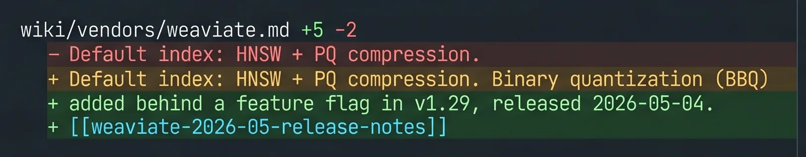

![A close-up of one diff hunk on a wiki vendor page: a competitor flipped binary quantization on behind a feature flag in v1.29 and the wiki picked up the change overnight.](/blog/assets/images/competition-b27f342926ff62653be88af28afa720b.webp)
