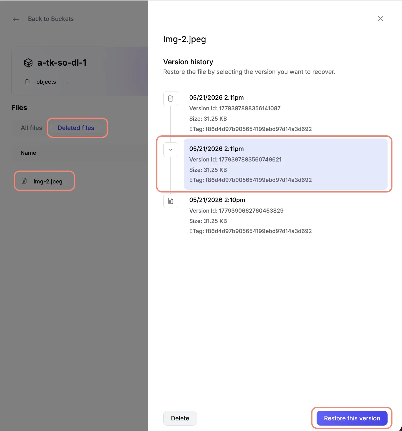

Inside any bucket with soft delete on, the dashboard splits the file list into All files and Deleted files. Pick a deleted object and the Version history panel opens on the right. It lists every soft-deleted version of that key with a timestamp, version ID, size, and ETag. Click restore on the one you want and the object is live again.
Figure 1. The Version history panel for a soft-deleted object, listing each version with its timestamp, version ID, size, and ETag. Each one is restorable on its own.
The Version history panel in the Tigris dashboard, listing soft-deleted versions of an object with timestamps, version IDs, sizes, and ETags

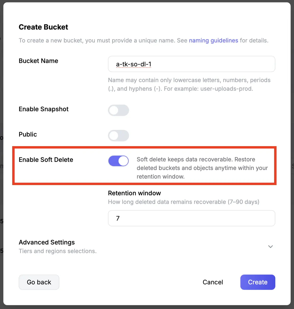

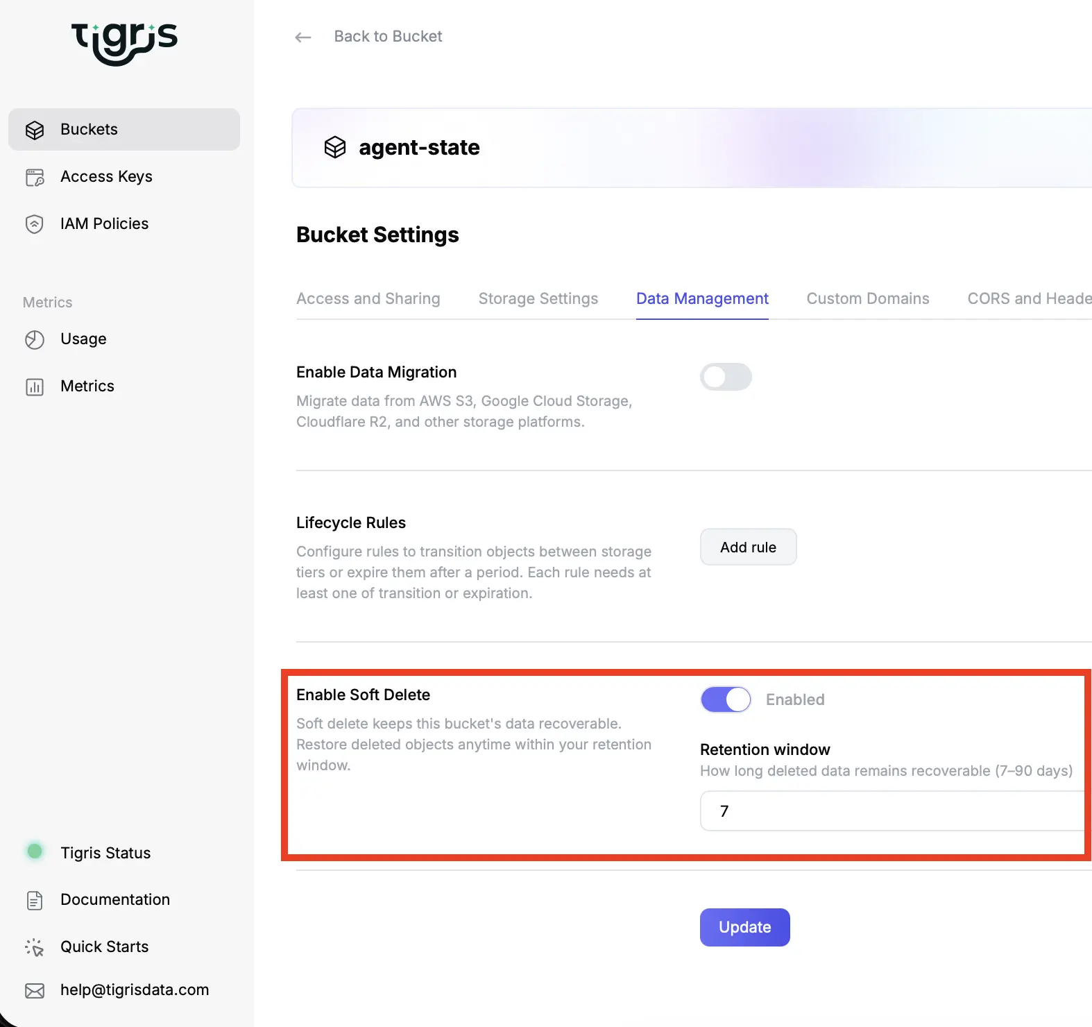

In the dashboard, you can toggle Enable Soft Delete when you create a bucket, or open Bucket Settings → Data Management on a bucket you already have.
Figure 2. Enabling soft delete in the Create Bucket dialog.
The Create Bucket dialog in the Tigris dashboard with the Enable Soft Delete toggle switched on and a retention window of 7 days set
Figure 3. Enabling soft delete from Bucket Settings → Data Management.
The Bucket Settings → Data Management tab in the Tigris dashboard with the Enable Soft Delete toggle switched on for an existing bucket

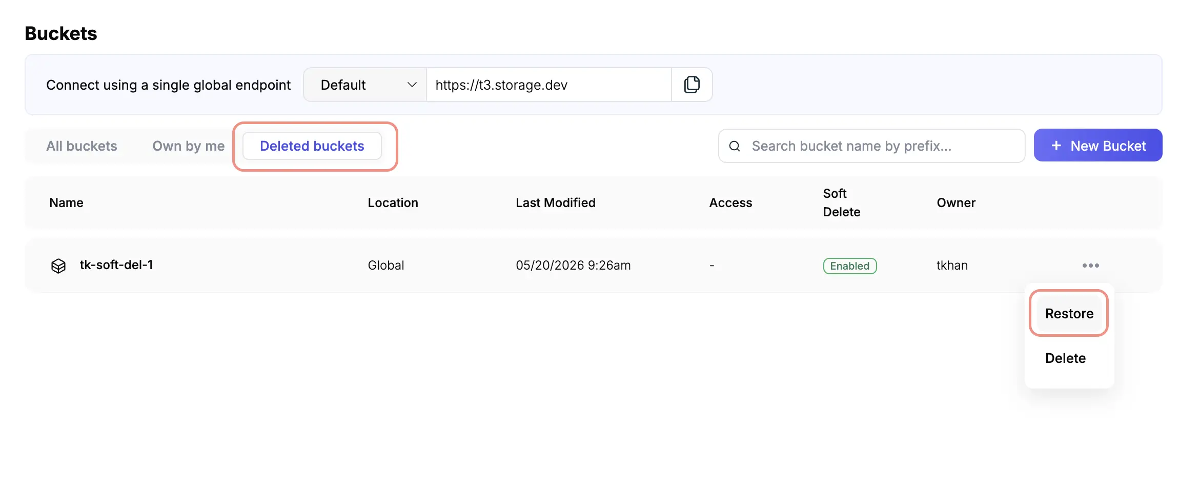

On the buckets page, a Deleted buckets segment lists every soft-deleted bucket that's still inside its retention window. Open the row's menu and click restore. The bucket reappears in the regular list. Every object it held when you deleted it is live and readable again.
Figure 4. The Deleted buckets segment in the Tigris dashboard, with a soft-deleted bucket's menu opened to the Restore action.
The Deleted buckets tab in the Tigris dashboard, showing a soft-deleted bucket with the overflow menu open and a Restore option available
