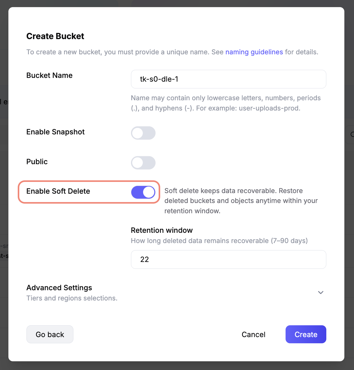

You can enable it when creating a bucket by toggling **Enable Soft Delete** in the Create Bucket dialog and choosing a retention window:
![Enable soft delete during bucket creation](/docs/assets/images/soft-delete-create-bucket-1708d231801cdd9fd0c18c77f1a10e90.png)

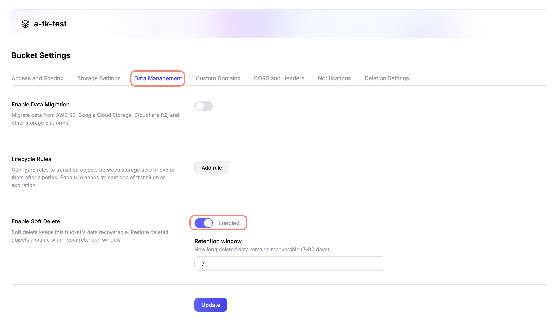

For an existing bucket, open **Bucket Settings → Data Management** and toggle **Enable Soft Delete**:

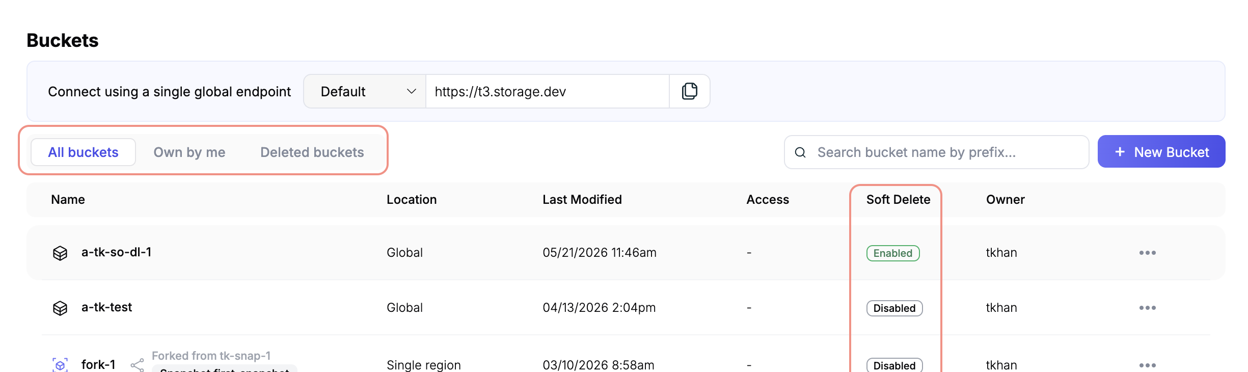

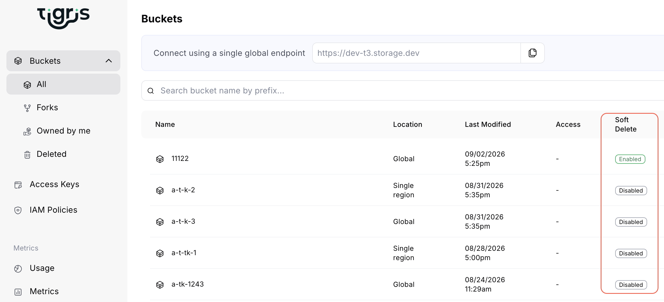

A **Soft Delete** column on the buckets list marks which buckets have soft delete enabled, showing **Enabled** or **Disabled** for each row.
![Buckets list with the Soft Delete column and the Deleted item in the sidebar](/docs/assets/images/soft-delete-col-segment-2b252b1846069225d2654111e9b418f6.png)

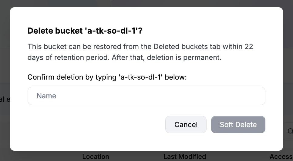

## Deleting a bucket with soft delete enabled[​](#deleting-a-bucket-with-soft-delete-enabled "Direct link to Deleting a bucket with soft delete enabled")
When you delete a bucket that has soft delete enabled, the delete confirmation dialog reflects that the action is recoverable instead of permanent. It tells you that you can restore the bucket. The action button is labeled **Soft Delete** rather than **Delete**, and you still confirm by typing the bucket name.
![Delete bucket confirmation dialog for a soft-delete-enabled bucket](/docs/assets/images/soft-delete-bucket-modal-7a4acdb3351a79e845d8311743993dd2.png)
This is the cue that the bucket is moving into the soft-deleted state covered below rather than being permanently removed.

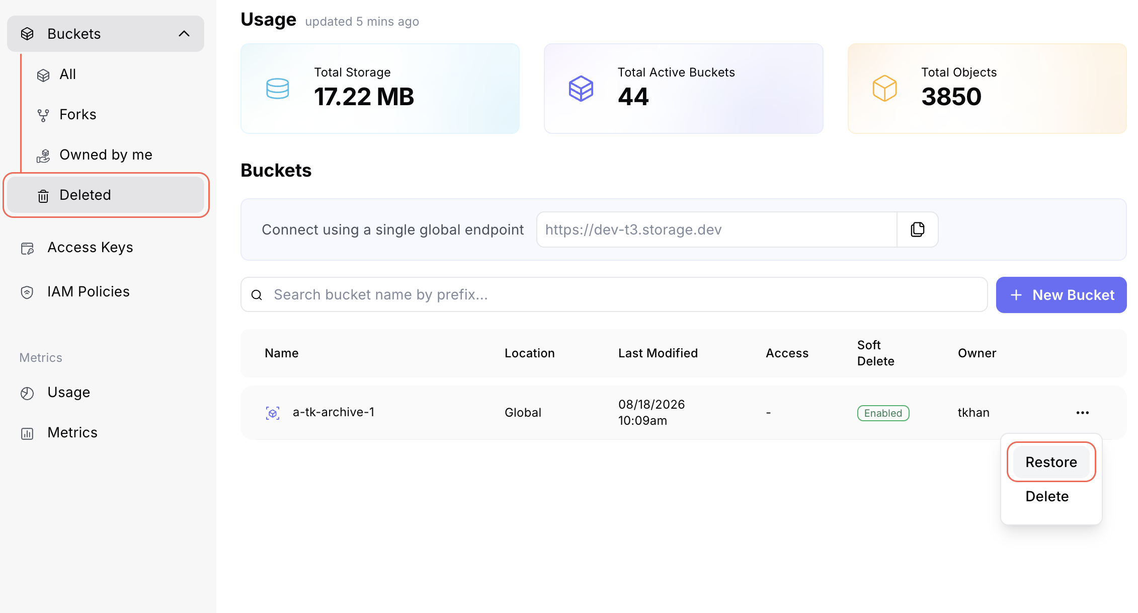

## Restoring a deleted bucket[​](#restoring-a-deleted-bucket "Direct link to Restoring a deleted bucket")
A bucket deleted while soft delete was enabled is not removed immediately. It moves to a soft-deleted state where it is hidden from your normal bucket list but stays recoverable until you restore it or permanently delete it.

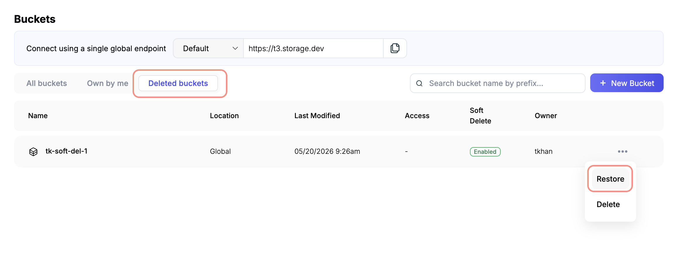

In the Tigris Dashboard sidebar, **Buckets** expands into **All**, **Forks**, **Owned by me**, and **Deleted**. Every bucket that was deleted while soft delete was enabled appears under **Deleted**. Each row in this view is a soft-deleted bucket.
To restore a bucket, open **Buckets → Deleted** in the sidebar. Then open the row's overflow menu (`...`) and choose **Restore**:
![Restore a soft-deleted bucket from Buckets, Deleted in the sidebar](/docs/assets/images/soft-delete-restore-bucket-fd8214e94f849db9ae6e80b4a05e5d00.png)
After a successful restore, the bucket is fully active again — it moves back to the regular bucket list and every object it held at the time of deletion is live and readable, exactly as it was before the bucket was deleted. To remove a soft-deleted bucket permanently, choose **Delete** from the same menu.
While a bucket is in the soft-deleted state, its name stays reserved — you cannot create a new bucket with the same name until either the bucket is restored or permanently removed.

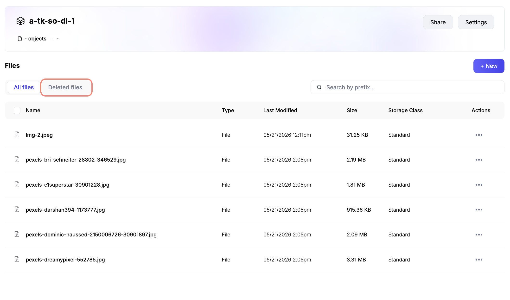

## Finding soft-deleted objects[​](#finding-soft-deleted-objects "Direct link to Finding soft-deleted objects")
Inside a soft-delete-enabled bucket, the files browser splits into an **All files** and a **Deleted files** segment above the list. **All files** is the regular live view; **Deleted files** is where every soft-deleted object in this bucket shows up while it's within its retention window.
![Files browser with All files and Deleted files segments](/docs/assets/images/soft-delete-files-segment-b74b0cbba817419afff3b411b4dc3cbf.png)

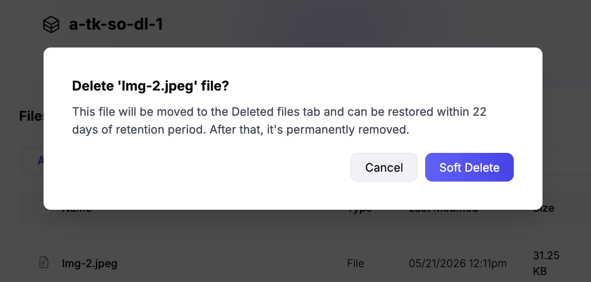

## Deleting an object in a soft-delete-enabled bucket[​](#deleting-an-object-in-a-soft-delete-enabled-bucket "Direct link to Deleting an object in a soft-delete-enabled bucket")
Deleting an object from the **All files** view brings up a confirmation dialog that mirrors the bucket-level one. It tells you the file will be moved to the **Deleted files** tab and can be restored within the bucket's retention period — and that after that window passes, the file is permanently removed.
![Soft delete confirmation dialog for an object](/docs/assets/images/soft-delete-object-delete-modal-92c1533fba8089e332124ef18f56fa36.png)

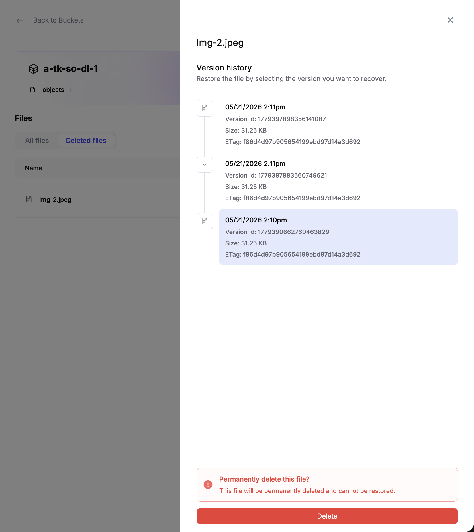

## Restoring a deleted object[​](#restoring-a-deleted-object "Direct link to Restoring a deleted object")

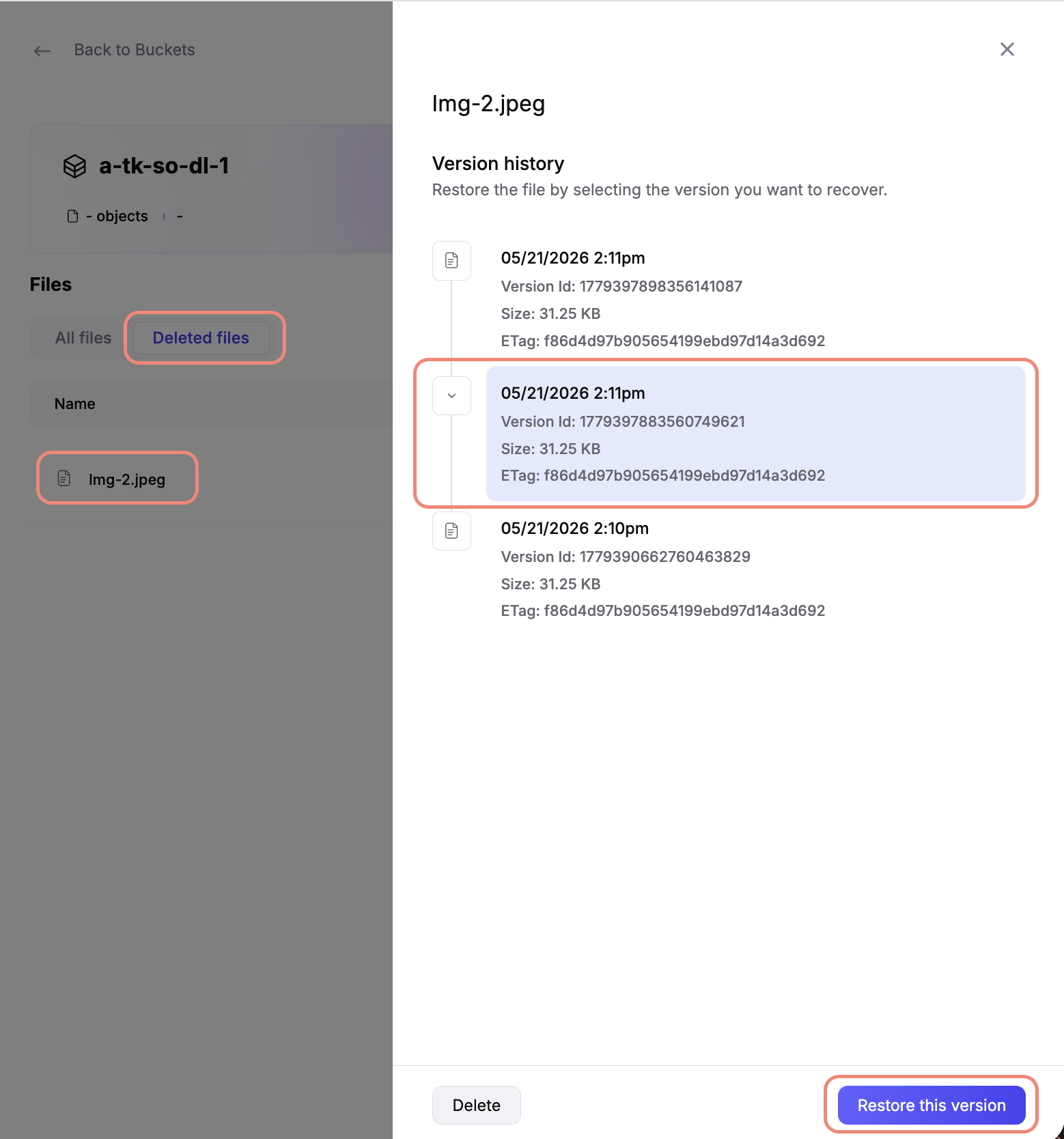

Every delete on a key produces its own soft-deleted version, stamped with the time it was deleted. The same key can therefore have many soft-deleted versions stacked up if it has been written and deleted more than once. For example, if you write an object at key `a`, delete it, write a fresh copy at `a`, delete that, then repeat one more time, the key will have three soft-deleted versions — one for each delete — all independently restorable until their retention windows expire.
In the **Deleted files** segment, selecting a deleted object opens its **Version history** panel on the right, which lists each soft-deleted version of that key along with its timestamp, version ID, size, and ETag. To restore the object, pick the version you want to recover and click **Restore this version**:
![Restore a soft-deleted object from the Deleted files tab](/docs/assets/images/soft-delete-restore-object-d4a06468e6590c92e80f3592b651211b.png)
The selected version becomes live immediately and is visible to all subsequent reads.

## Permanently deleting an object[​](#permanently-deleting-an-object "Direct link to Permanently deleting an object")
Permanently deleting a soft-deleted object is always scoped to a specific version of that object. There is no single "delete the object" button — because the same key can have many soft-deleted versions stacked up, you pick which version to purge from the **Version history** panel.
To do this, open the **Version history** panel for the object in the **Deleted files** segment, select the version you want to purge, and click the red **Delete** button at the bottom of the panel. The panel shows a **Permanently delete this file?** confirmation just above the button, calling out that the version will be permanently deleted and cannot be restored.
![Permanently delete a soft-deleted version from the Version history panel](/docs/assets/images/soft-delete-permanent-delete-version-509108a1913ea01df1ec1dc94f3c4a32.png)
Unlike the regular delete from the **All files** view, this action bypasses the retention window entirely — the selected version is purged immediately and is not recoverable. To fully remove an object that has multiple soft-deleted versions, repeat this for each version you want gone.

### Restoring an object[​](#restoring-an-object "Direct link to Restoring an object")
Send `RestoreObject` with `X-Tigris-Restore-Type: soft-delete`:
POST /my-bucket/contracts/2026/q1.pdf?restore HTTP/1.1
Host: t3.storage.dev
X-Tigris-Restore-Version: 1787441627070249004
The response is 200 with an empty body, and the object is immediately live for all subsequent reads. The request body is ignored.
`X-Tigris-Restore-Version` takes a `VersionId` from the versions listing. Without this header, Tigris restores the most recent deleted version of the key.
* Go
* TypeScript
* CLI
// An empty VersionID restores the most recent deleted version of the key.
_, err := client.RestoreSoftDeletedObject(ctx, &storage.RestoreSoftDeletedObjectInput{
	Bucket:    "my-bucket",
	Key:       "contracts/2026/q1.pdf",
	VersionID: "1787441627070249004",
	log.Fatal(err)
import { restoreDeletedObject } from "@tigrisdata/storage";
const { error } = await restoreDeletedObject(
// These calls return an error rather than throwing one.
if (error) {
  throw error;
tigris objects restore-deleted my-bucket contracts/2026/q1.pdf \
  --version-id 1787441627070249004
`--version-id` is required. Take the value from `tigris objects list-versions <bucket> --deleted`.
A restore keeps the content, the ETag, the content type, the user metadata, and the storage class of the deleted object. It gives the object a new `Last-Modified`, which is the time of the restore.
warning
A restore replaces a live object at the same key. The replaced object becomes a new deleted version.
The deleted version stays in the deleted listing until its retention window ends, also after a restore. A second restore of the same version writes the same content again.
These are the errors of a restore:
* 400 `InvalidArgument` / `Soft-delete is not enabled on this bucket` — soft delete is off on the bucket.
* 400 `InvalidArgument` / `Invalid restore version: must be unix nano timestamp` — the header value is not a number.
* 404 `NoSuchKey` — the key has no deleted version, the retention window ended, or the version ID is not a version of this key.
