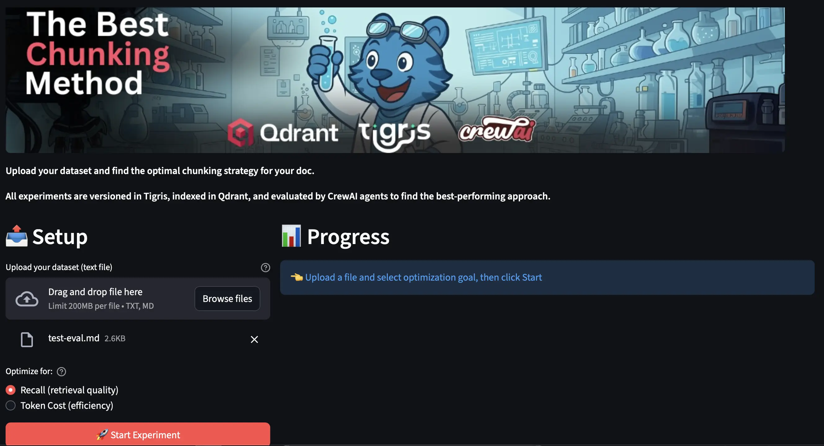

We built [**a small Python app**](https://github.com/davidmyriel/tigris-rag-lab) to help you discover the optimal chunking strategy without manual testing or guesswork. The evaluation automatically compares multiple strategies: paragraph, sentence, markdown, recursive, window, none - and ranks them using objective span-based metrics.

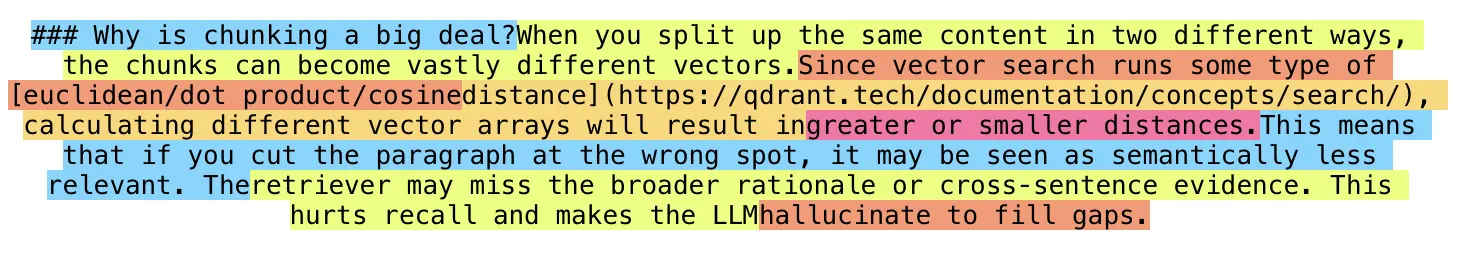

When you split up the same content in two different ways, the chunks can become vastly different vectors. Since vector search runs some type of [euclidean/dot product/cosine distance](https://qdrant.tech/documentation/concepts/search/), calculating different vector arrays will result in greater or smaller distances.
This means that if you cut the paragraph at the wrong spot, it may be seen as semantically less relevant. The retriever may miss the broader rationale or cross‑sentence evidence. This hurts recall and makes the LLM hallucinate to fill gaps.
Figure 0: splits document data recursively to keep all paragraphs, sentences then words together as long as possible.

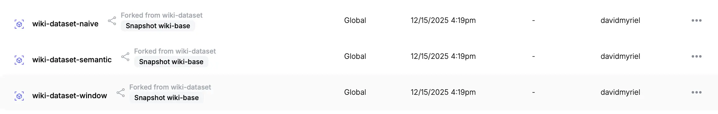

A Tigris bucket fork is a new bucket that starts from an existing bucket's state at a specific point in time, then evolves independently. From that moment on, anything you write or delete in the fork is isolated, and the original bucket stays untouched.
A fork can be created fast even for very large datasets because it is a **zero-copy** operation at creation time. Tigris does not duplicate all objects up front—instead it clones the bucket's metadata, so unchanged objects are effectively shared and only differences created after the fork require additional storage.
**Figure 1:** For each tested dataset, you can have a separate bucket with different chunks.
![Image 2](/blog/assets/images/image2-07f14bbacc4372976d7692504eb62fe0.webp)
Forks also work cleanly with snapshots. You can fork from the bucket's current state or from a named snapshot, which makes experiments reproducible. If you're doing evaluation-driven dataset improvement, that maps perfectly to how you already think about iteration:
* **snapshot** = "baseline state I trust"
* **fork** = "test storage for an experiment"
* **keep fork** = "retain the best result"
* **delete fork** = "discard the losers"

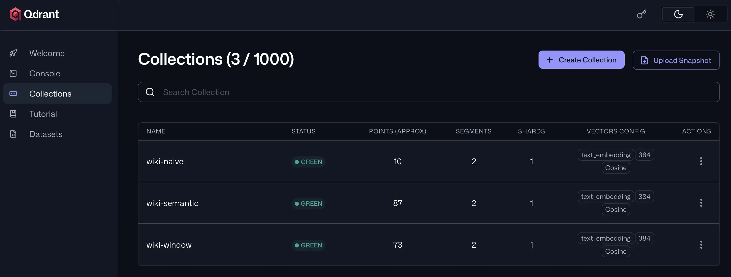

### **Vector indexing and search with Qdrant**[​](#vector-indexing-and-search-with-qdrant "Direct link to vector-indexing-and-search-with-qdrant")
Downstream, each fork's chunk output becomes its own Qdrant collection, giving you a clean 1:1 mapping.
> For details on collections, payload schemas, and search parameters, see the [Qdrant documentation](https://qdrant.tech/documentation/):
* **bucket fork** = experiment artifact namespace
* **Qdrant collection** = experiment retrieval behavior
That matters because it keeps comparisons fair: no shared index state, no accidental reuse of embeddings, no "it improved because the cache was warm" confusion.
**Figure 2:** Top K evaluation using vector search is run using Qdrant vector database. Each experiment tests recall using the vector index.
![Image 3](/blog/assets/images/image3-1ae24222aa698ca9bdc796a8ff03318a.webp)

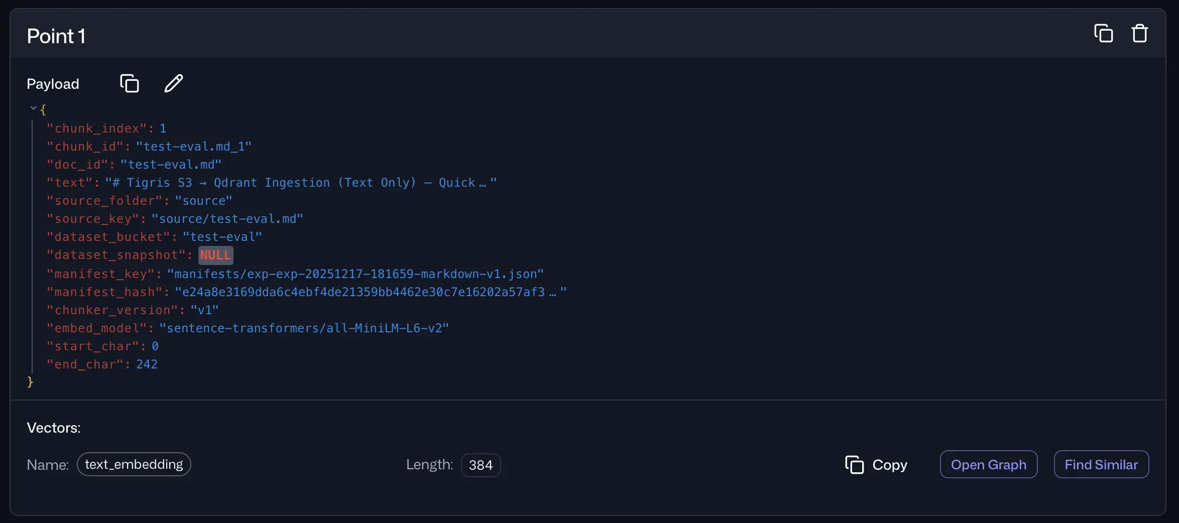

Each fork contains the dataset artifacts for exactly one hypothesis (one chunking strategy). That means when you later look at results you can say:
*"This score came from *that* fork, built from *that* chunking strategy, against *that* indexed collection."*
**Figure 3:** There's no ambiguity because each vector carries a metadata manifest with it.
![Image 4](/blog/assets/images/image4-ae57bad55b7b93975dbd54a1b04c2237.webp)

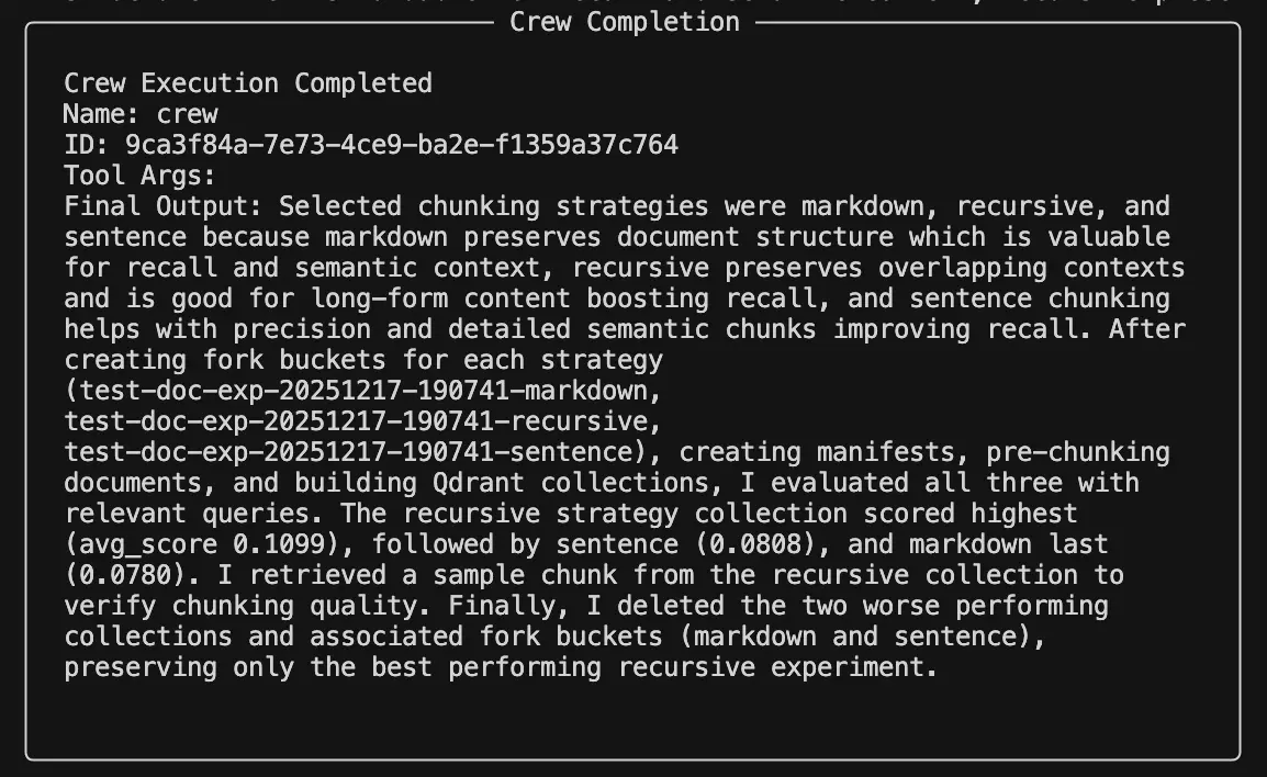

The fork is the "experiment container." The evaluation score is the "CI check." And the "deployment" is simply: keep the winning fork around.
**Figure 4:** The CrewAI Analysis Agent concludes the procedure by outlining which chunking strategies were used and why the high performing one was chosen.
![Image 5](/blog/assets/images/image5-974b44662d03da4dad08580b6908d6d3.webp)
